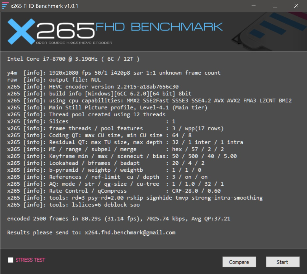

AMD Ryzen 5 5600 6-Core  @ 4.65GHz ( 6C / 12T )
y4m  [info]: 1920x1080 fps 50/1 i420p8 sar 1:1 unknown frame count
raw  [info]: output file: NUL
x265 [info]: HEVC encoder version 2.2+15-a18ab7656c30
x265 [info]: build info [Windows][GCC 6.2.0][64 bit] 8bit
x265 [info]: using cpu capabilities: MMX2 SSE2Fast SSSE3 SSE4.2 AVX AVX2 FMA3 LZCNT BMI2
x265 [info]: Main Still Picture profile, Level-4.1 (Main tier)
x265 [info]: Thread pool created using 12 threads
x265 [info]: Slices                              : 1
x265 [info]: frame threads / pool features       : 3 / wpp(17 rows)
x265 [info]: Coding QT: max CU size, min CU size : 64 / 8
x265 [info]: Residual QT: max TU size, max depth : 32 / 1 inter / 1 intra
x265 [info]: ME / range / subpel / merge         : hex / 57 / 2 / 2
x265 [info]: Keyframe min / max / scenecut / bias: 50 / 500 / 40 / 5.00
x265 [info]: Lookahead / bframes / badapt        : 20 / 4 / 2
x265 [info]: b-pyramid / weightp / weightb       : 1 / 1 / 0
x265 [info]: References / ref-limit  cu / depth  : 3 / on / on
x265 [info]: AQ: mode / str / qg-size / cu-tree  : 1 / 1.0 / 32 / 1
x265 [info]: Rate Control / qCompress            : CRF-28.0 / 0.60
x265 [info]: tools: rd=3 psy-rd=2.00 rskip signhide tmvp strong-intra-smoothing
x265 [info]: tools: lslices=6 deblock sao
encoded 2500 frames in 60.48s (41.33 fps), 7025.74 kbps, Avg QP:37.21
A tu 4.725 GHz
AMD Ryzen 5 5600 6-Core  @ 4.72GHz ( 6C / 12T )
encoded 2500 frames in 59.27s (42.18 fps), 7025.74 kbps, Avg QP:37.21
Edytowane przez Pentium D
